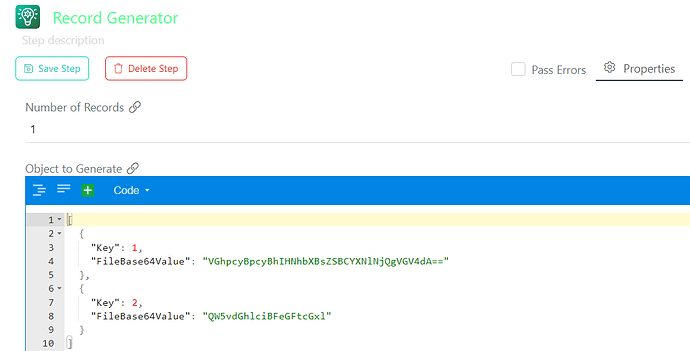

Illustrated in the image below is an example of a flow where the payload is from a Record Generator source step which decodes the base64 string into text by using JSON code in a Calculator step.
The Record Generator source step contains a payload with a Key and base64 encoded value as shown in the below image.
